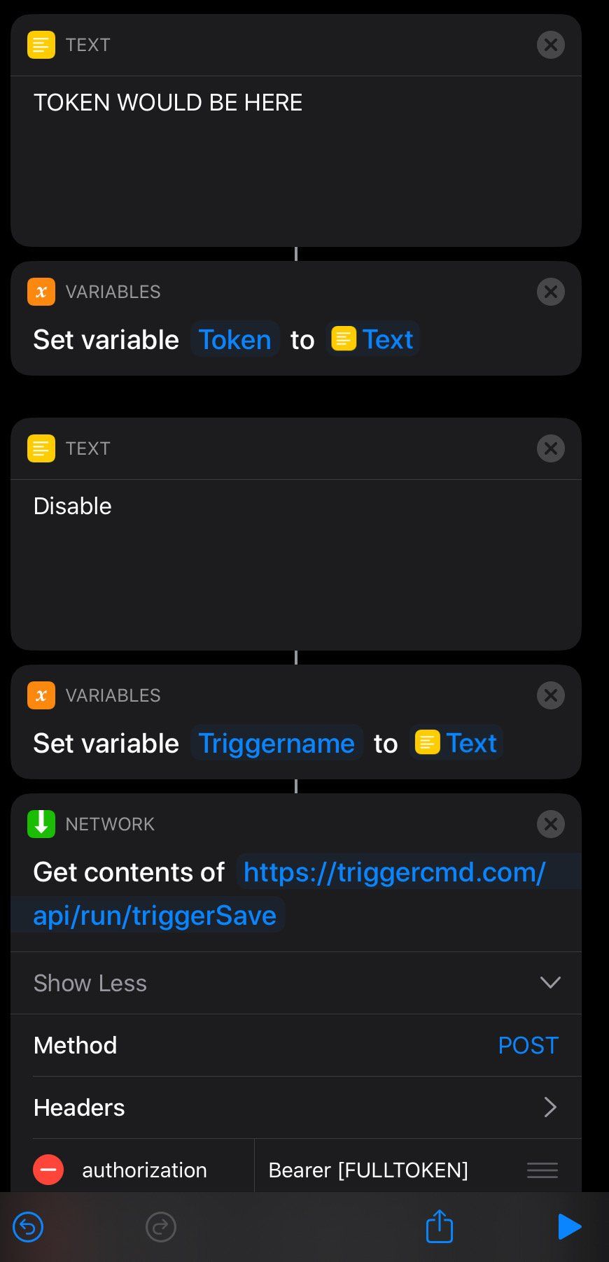

      Hey,
      I tried to follow the instructions from https://www.triggercmd.com/forum/topic/347/trigger-from-shortcuts-ios
      but I keep getting An "Invalid Token" response. Any ideas? Thank you
      signal-attachment-2020-04-02-200101_001.jpeg signal-attachment-2020-04-02-200101_002.jpeg
        Russ @A Former User
        @Lewis-S, I'm not sure why that's not working. I need to buy an iOS device. My iPad is now too old to run the Shortcuts app.
        In the meantime, you could remove the authorization header and instead send the token as another parameter called token in the Request Body section.
        Also, I'm not sure those { and }'s are necessary. You could try without those if it still doesn't work. I'm pretty sure they would not be necessary if you switch from JSON to Form.
        ? 1 Reply Last reply Reply Quote 0
          A Former User @Russ
          @Russ That worked! Once i moved the token, and removed all the curlybrackets, it worked! Thank you very much.

                    Russ @user01010
                    @user01010, I'm working on getting an iOS device so I can take some screenshots, but in the meantime you can look at the screenshots above, and change these things:
                    1. Remove the "authorization" header
                    2. Add "token" under Request Body and paste your token from the Instructions page in as the value.
                    3. Remove the } and { characters.
                    4. Optional: change computername and triggername to computer and trigger.
                    Example:
                    computer=macbook
                    trigger=calculator
                    token=(token from the instructions page)
