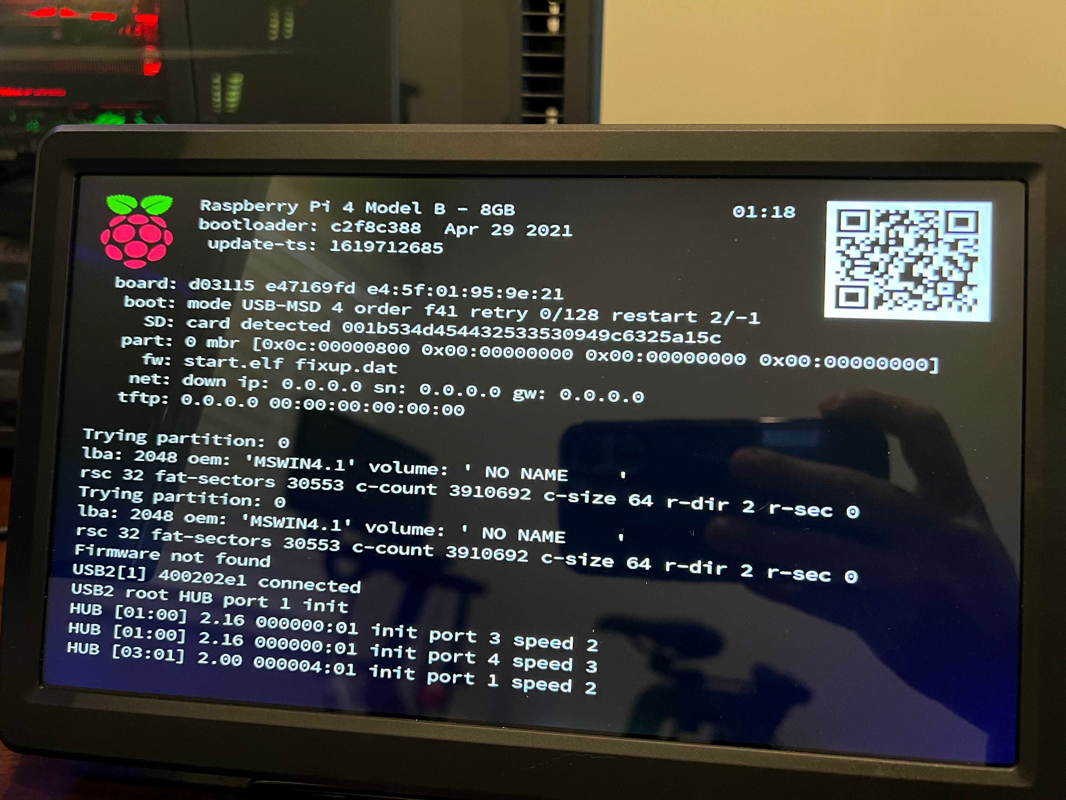

        Not sure if this is expected to work anymore. My setup gets stuck at the boot screen.
        • Dean McNaughtonD Dean McNaughton referenced this topic on
          Russ @Dean McNaughton
          @dean-mcnaughton, I'll test it. Just to confirm, you formatted your SD card, then ran setup.bat? Did you confirm setup.bat wrote data to your SD card before you put it in your Raspberry Pi?
          Dean McNaughtonD 1 Reply Last reply Reply Quote 0
          • Dean McNaughtonD
            Dean McNaughton @Russ
            I think the batch file wrote info to the card, but can't remember for sure. I'm hesitant to repeat the experiment right now because the SSD card is configured and running Raspberry Pi OS.
            As far as I'm concerned, this is not an active issue for me anymore because I installed it a different way; I should have followed up to let you know. Thank you for looking into it and responding though!
