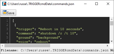

      I just subscribed to TriggerCMD and created a number of commands to run X10 modules on my test computer to make sure it worked as expected and now would like to move those commands to my main computer. I cannot find any export or save file feature. Can you please advise how to move these over to the new computer. As mentioned, I did subscribe / am not using the 'free' service. Thank you.
        Russ @Frank Malczewski
        @Frank-Malczewski, to move your commands to the new computer, you can copy your commands.json file to the new computer, or use the "Text Command Editor" (screenshot below) to copy/paste the contents:
        Also, thank you for subscribing!
