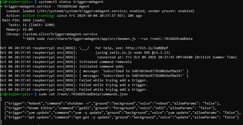

      I double checked the commands.json file and there were no spurious commas, the last line had no comma. I got two "Failed to add..." errors - which matched the number of triggers i had (both background). To try to rule out my json, I copied the default file, with the 4 triggers in (3 background and 1 foreground) and re ran the installdaemon.sh. Again everything seemed ok but checking the status (via systemctl status triggercmdagent) I can see 3 "failed while trying to add a trigger" errors, probably corresponding to the 3 background triggers it is trying to use. As a final attempt i tried uninstalling the software (via the removedaemon.sh script, removing the machine from the computer management page, then reinstalling, again I get the 3 errors.

          It is the commands.json in /root/ that i am editing. When I edited it to contain the two background commands I want, I got 2 errors. When I did a fresh uninstall and install, so the commands.json in /root/ had 3 background commands, I got 3 errors. This is my as output as my PI is currently:
          Thanks again for taking the time to help with this.

            @MarkW, I'm confused because you said you edited the commands.json, but the one you cat'ed out has the default commands in it.

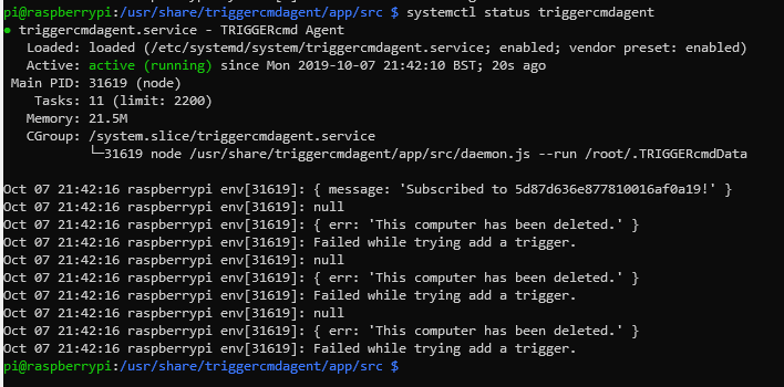

              I added the log lines you suggested and got the following output (at the end of the journalctl command):

              and got the same error:
              I am not sure why the service believes the computer has been deleted when it was registered in this same session only a minute or so before.

                @MarkW, for some reason it seems to be trying to use the old computer's ID, not the new one. I tried to reproduce this issue and I couldn't, but I'm running the latest version of the agent. Maybe that's the difference.
