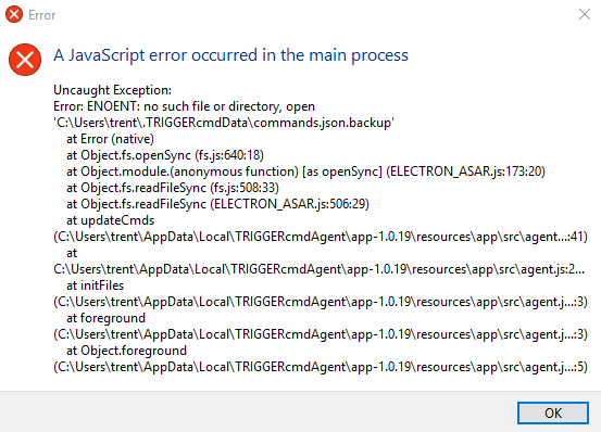

      When I try to install Triggercmd on my Windows 10 computer I get a Javascript error message. I can't copy the text in the error message. I copied an image to here but I am not sure it will show up. Does anyone know what the problem is and how to fix it?
      Javascript Error
      Can anyone help me figure out what is wrong? Do I need to re-install TRIGGERcmd Agent?

        @zipster1967, I think you do need to re-install TRIGGERcmd agent, but before you reinstall, will you please try disabling your Antivirus software? Some Antivirus software breaks the installer system TRIGGERcmd uses.
        Also, can you tell me what Antivirus software you use? I'd like to see if there's a way to make the installer compatible.

          I disabled my Avast antivirus protection and uninstalled the triggercmd from my apps list but when I run the setup again I get the same java error message dialog.0_1547912220517_TRIGGERcmd Install Error.png
          My antivirus I am using is Avast. I hope that helps.

            @zipster1967, ok, please try deleting your C:\Users\trent\.TRIGGERcmdData folder. I've seen Avast cause problems in the past, and I suspect it put your data folder in a broken state. If you delete the folder, TRIGGERcmd will re-create it. I think once the data folder gets created, you can turn Avast back on.

              That did it. I got it installed just fine. Thanks.
