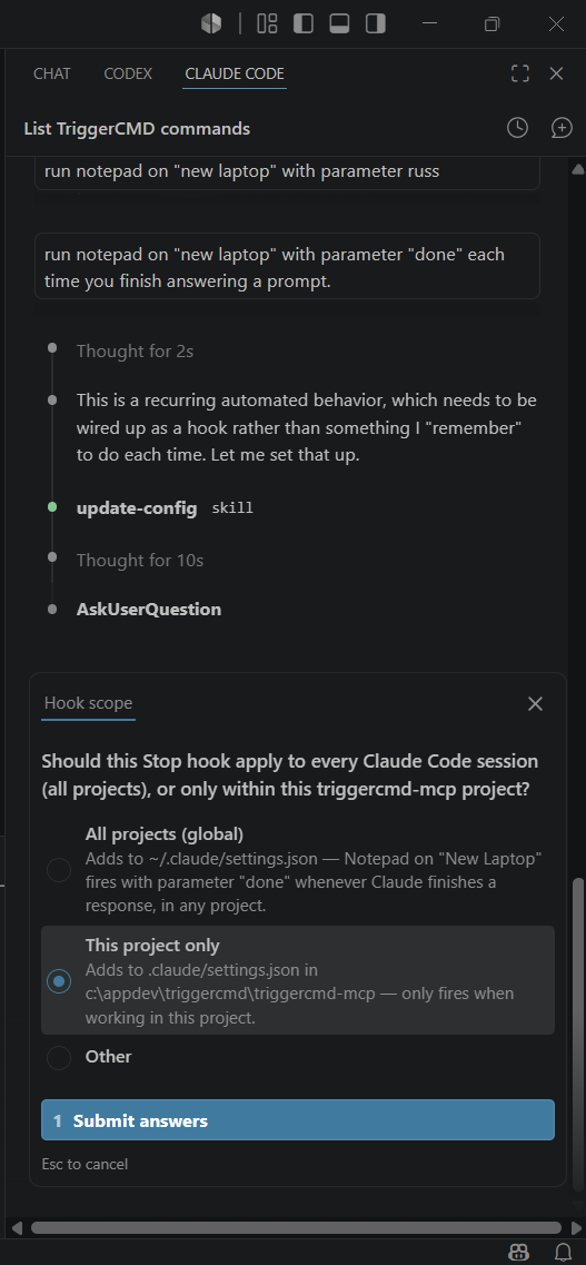

    You could have Claude run a command each time it finishes a prompt.
    Scheduled Pinned Locked Moved MCP
    1 Posts 1 Posters 150 Views 1 Watching
      One idea: turn a light green when it's finished, and turn it red when it's working on something.
      I tend to use the notepad command when I test parameters.
      [repo path]\.claude\settings.json:
        "hooks": {
          "UserPromptSubmit": [
              "hooks": [
                  "type": "mcp_tool",
                  "server": "triggercmd",
                  "tool": "run_command",
                  "input": {
                    "computer": "New Laptop",
                    "command": "Notepad",
                    "parameters": "started"
          "Stop": [
              "hooks": [
                  "type": "mcp_tool",
                  "input": {
                    "parameters": "done"
