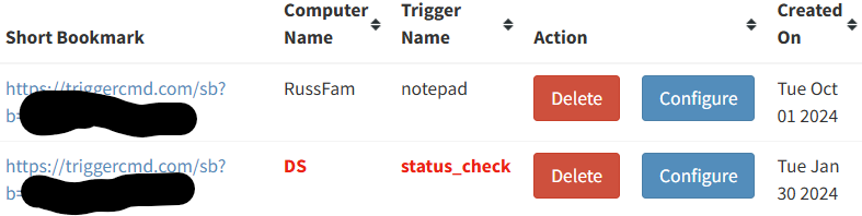

        @Smart-Communities the red on the Short Bookmarks page is not showing the online/offline status of the computer. It's telling you that the command/computer combo no longer exists.
        For example, I have a command on my DS computer that no longer exists. I probably renamed it.

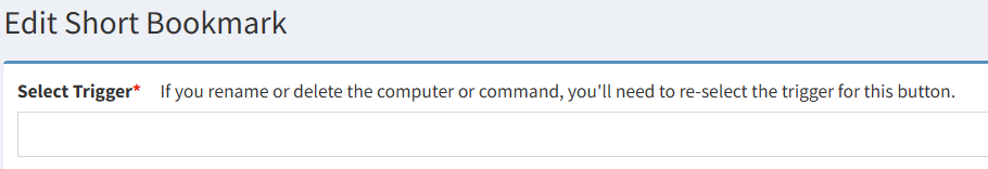

        If you click Configure, it will show you a blank Select Trigger field with a pulldown to re-select something for that short bookmark URL.

          @Russ Hey man. No need to move the "create short bookmark" link. I was wanting the ability to view all standard and short bookmarks for a specific PC in the same screen.
          Anyway the offline issue. The PC is green and showing the 3 active Triggers one of which is the reboot one that's there upon install. I just went to create a short bookmark and it shows up as red.

            @Smart-Communities, I think you need to edit your short bookmark and re-select your reboot command.
            I suspect maybe you renamed your computer?
            I just did that - I added a space between New and Laptop. It made my short bookmark red because it no longer matched the computer name:
            Then I fixed it by editing my short bookmark and re-selecting my reboot command:

              @Russ I haven't renamed the computer. It looks like it's being cut off in the short bookmarks page. Maybe that's why it thinks the pc doesn't exist? I'll change it to something shorter and see if that fixes it.

                @Smart-Communities, why not click that Configure button for your short bookmark, and re-select the computer/command combo?

                  It worked. Now it shows the full name of the PC and the indicator is black.
