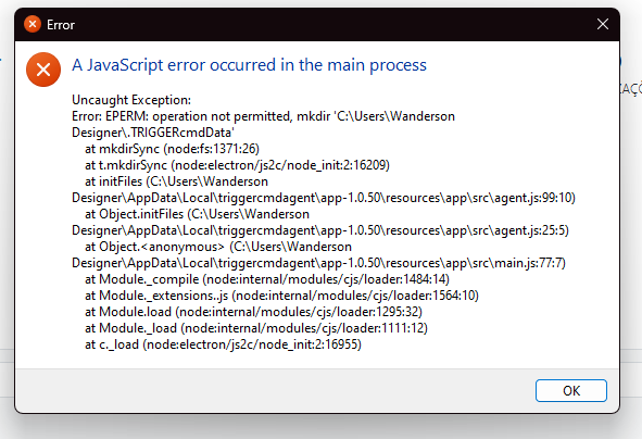

      Hello good afternoon, I have an error when installing triggercmd. I have already done all the procedures indicated and nothing, the JAVA error still persists, I have already deleted the backup folders and the folders that are temporary files, but the same error persists, could you help me? I use an adm x570 motherboard, amd 5500 processor.![alt text](image ur08d28705-4377-43b9-ac73-2a2f387ea9f3-image.png l)
      ![alt text](image ur162fb412-535e-4b0c-985a-73f56a141e4e-Screenshot_1.png l)

        @wandersonjvs, thanks for the screenshots. I suspect you have some antivirus software that's preventing the agent from creating the .TRIGGERcmdData folder under your user's home folder.
        You could try creating it manually, or you could try temporarily disabling your antivirus software.
