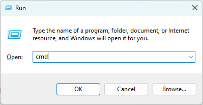

        @Matheus-de-Souza, it's showing "Command ran with error code 1" because your command is failing. Commands return error code 0 when they succeed.
        To troubleshoot, it would help to get the output of your command. You should be able to see the error if you run it manually from a cmd prompt.
        To open a cmd prompt, you can hold the Windows key and press R, then type cmd and press enter.
        If the command runs fine in the cmd prompt but it fails when you run it with the TRIGGERcmd agent, you should copy/paste your command into a .bat file and redirect the command's output to a log file, and change your triggercmd command to run the .bat file. That way you can look in the log file to see the error.
        For example, you could create a script.bat file with these contents:
        yourcommand > c:\logs\script.log 2>&1
        This part is to make stderr output go into your log, not just stdout: 2>&1
        Notice I put the log file in a c:\logs directory. You'll need to create that directory first. Windows won't let you write to a file in c:\ by default.
