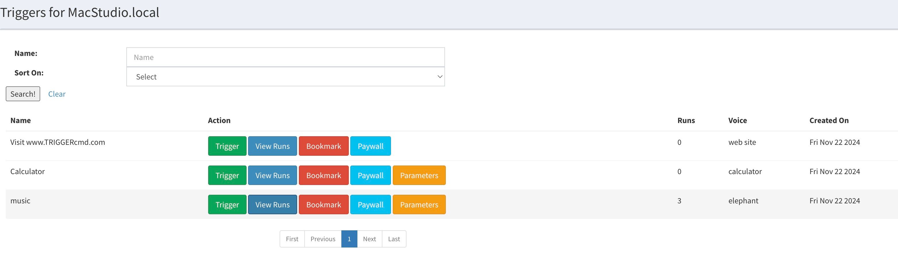

        It is linked. No devices show up in the Alexa device list for any of the two commands that have a voice word. (Calculator, Elephant).
        R 1 Reply Last reply Nov 23, 2024, 1:46 PM Reply Quote 0

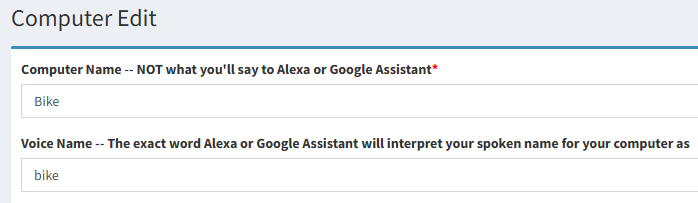

          Please go into your profile page and make sure your MacStudio.local computer is your default computer. Or, make sure that computer has a Voice Name. One or the other is necessary for Alexa to create devices for your computers.
          I recommand making it your default computer so you can just say, "Alexa, turn on calculator" rather than "Alexa, turn on calculator on mac" (assuming you'd make the Voice Name "mac").
          https://docs.triggercmd.com/#/./SmartHomeSwitches
