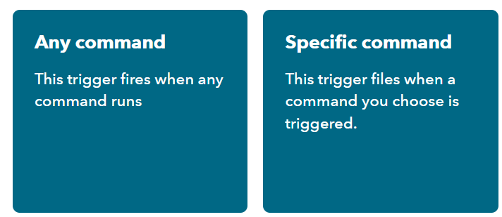

        Russ @Emanuel Werner
        @Emanuel-Werner, are you using "If any command is triggered ..." as your applet trigger? Or are you using "Specific command"?
        I'll test this later today to see if I can reproduce the issue.
        EDIT: I was able to reproduce the issue. Like you, I setup 2 applets that were supposed to run when two separate specific commands ran, but when I ran one command, both applets ran. Thank you for reporting this bug. I'll work on it and let you know when it's fixed.
