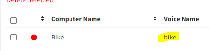

      • Bryan MadrigalB Offline
        Bryan Madrigal @Bryan Madrigal
        alt text
        When i search the devices, i can’t look the trigger action on google home!
        The computer is linked!
        And the command is created in computer!
        But I can’t action this from google assistant!
        alt text
          Russ @Bryan Madrigal
          @Bryan-Madrigal, I see the problem.
          You don't have a default computer, and your computer doesn't have a voice name.
          Virtual switches will only be added to Google Home (or Alexa) if one of these is true:
          1. Your computer is your Default computer. You can set that in your profile page.
          2. Your computer has a Voice Name
          I recommend #1 because the virtual switches will have a shorter name - like "Calculator" instead of "Calculator on Computer"
          Bryan MadrigalB 1 Reply Last reply Reply Quote 0
            Bryan Madrigal @Russ
            @Russ Thanks 🙏🏻 it’s really works for me!
            I suggest you add a note in this setting up a computer, because I would never have know if you didn’t tell me.
            I congrats for your effort!
            Thank you so much! 😊
