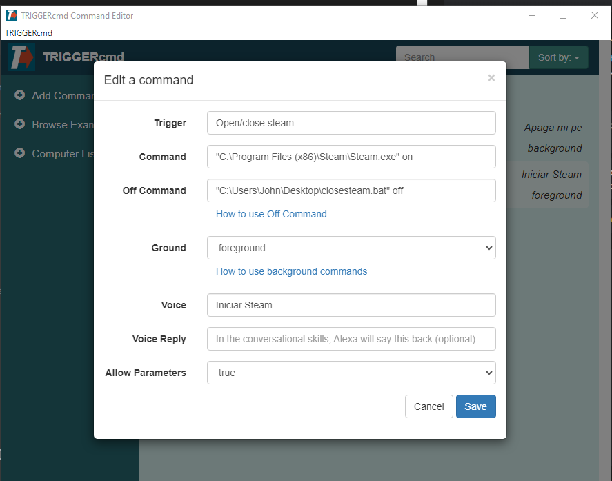

      Hello!
      I have a routine integrated with TriggerCMD but it only works from my phone (google home) and not from my pc.
      What i made successfully is create a Routine on the Google Script editor that whenever i start my command/trigger, it opens steam.exe, this triggers my led strip on or off, depending on the parameter sent (both starters on the same code)

      this is on the .bat file:
      taskkill /F /IM Steam.exe
      I added on the triggercmd Command and off command on and off text to the end, i dont know if that sends the parameter but at least is working (maybe if i delete that it works anyway)
      But what is not working is the automation triggering when i open the shortcut from my pc or the .exe, is it possible to make it work like my phone? i want to open Steam from my desktop and this triggers my routine, therefore turning on my strip lights and also when i stop/kill/close the .exe it turns off my light, i cant make it work like that

        Russ @john lagos ramirez
        @john-lagos-ramirez, if you open and close steam from your PC via TRIGGERcmd it should trigger your Google Home routines that turn your lights on/off.
        Please try this:
        1. Download the tcmd tool
        2. Rename it to tcmd.exe
        3. Move it in your c:\windows folder so it's in your PATH.
        4. Right-click your desktop and create 2 shortcuts that run these two commands:
          tcmd -t "Open/close steam"-c "PC John"-p on
          tcmd -t "Open/close steam"-c "PC John"-p off

        • john lagos ramirezJ
          john lagos ramirez @Russ
          Hi @Russ
          I followed your instructions and it is working excellent now 👌
          Thank you so much!
