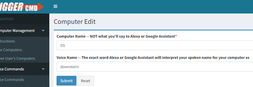

          @Sam-Shum, you probably just need to change your default computer to your new one.
          You'll find this setting in your Profile page.
          Or, you could give your new computer a voice name.
          We both posted at the same time. I see you copied your computerid.cfg file over. That works too, but then your old computer and your new computer will get the same triggers at the same time because they'll both login as the same computer.
          Normally, when you have multiple computers, you can run commands on your default computer with Alexa commands like, "Alexa, turn on calculator" and your other computers with Alexa commands like, "Alexa, turn on calculator on laptop" where "laptop" is the Voice Name for your non-default computer. You can see a list of your voice commands for all computers on the Smart Home Voice Commands page.
