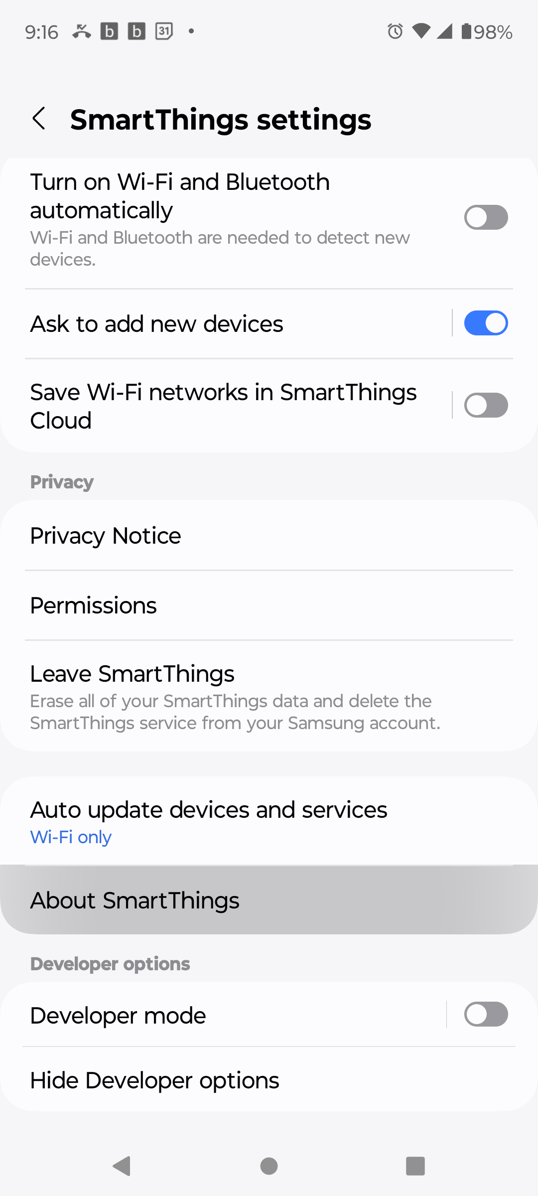

        @AZRushFan, have a new phone and I just now re-enabled developer mode in the SmartThings app. I held down About for a long time, maybe 10 seconds just to be sure. It worked for me. I too this screenshot.

          @Russ I wonder if it is an iOS issue as held it down for well over 10s and no love. I will see if I can locate an Android to test.
