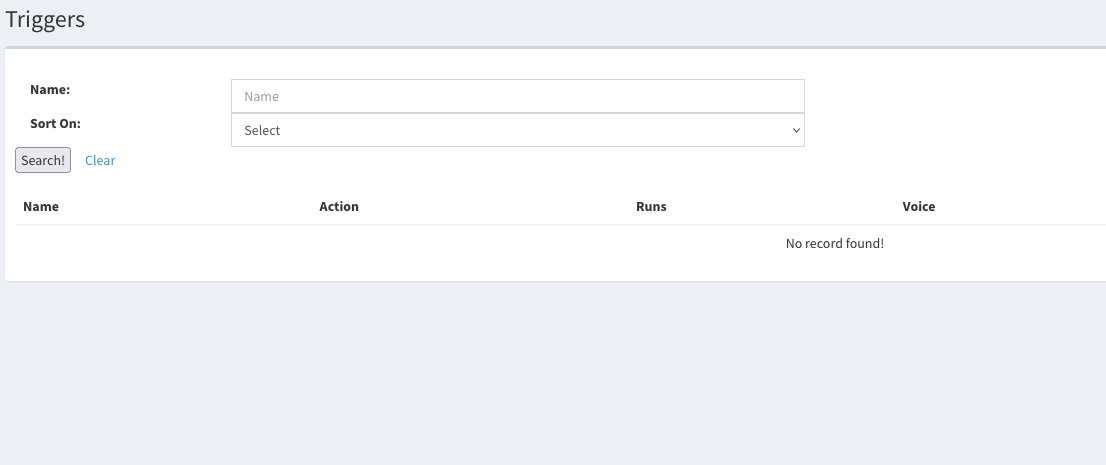

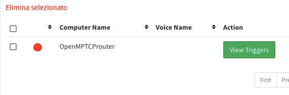

                      Then Into the web paanel I can see my router but the trigger standard already present aren't loaded
                      How you can see if I click on "View Triggers" nothing is loaded

                        @eromano resolved by a new install from zero.
                        Maybe the problem was that at the first execute was already present another machine
