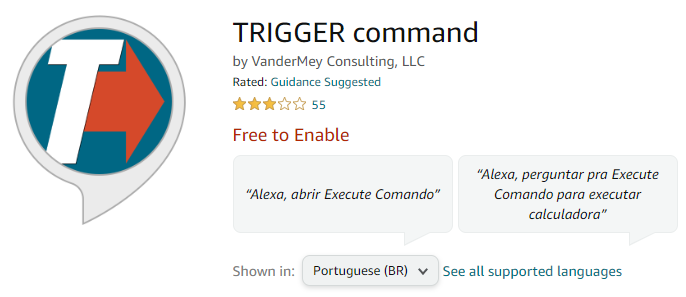

              I just noticed that the TRIGGERcmd skill is not available for Brazil,
              Anyway, thanks for the support.
                Russ @santana2196
                @santana2196, oh that's true. Sorry. Please use one of the other conversational skills.
                I think I'd recommend the TC skill in this case.
                Also, please check out the portuguese documentation page about the conversational actions.
