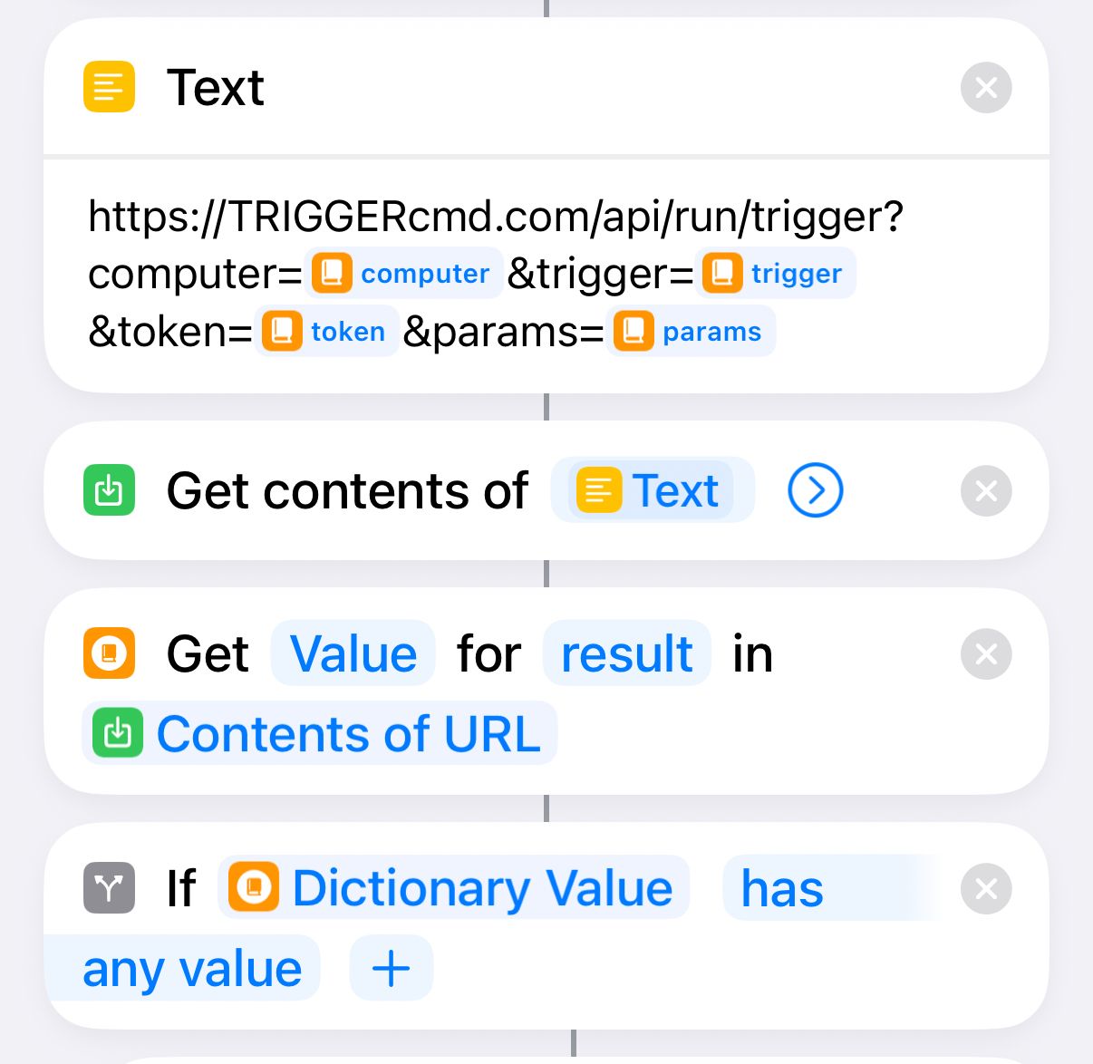

                @Russ brilliant! yes, I had made sendresult.sh executable previously. but the response change made parsing the result easier as you say. other stumbling blocks fixed:
                • the trigger value in the shortcut configuration needed a "%20" instead of a space, as the command name had a space!
                • the value for "computer" has to be the actual computer name in TriggerCMD, not laptop or maclaptop etc. (DUH).
                • then what I needed in the first steps of the shortcut was this:
                … etc. (you need to work with the variable "dictionary value" in this case.)
