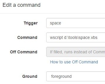

                                  Russ @Laaderlappen
                                  @Laaderlappen, I use Plex alot myself. I just tested space and it was able to play/pause on my PC. There are a few ways, but this is how I did it.
                                  This is my command:
                                  wscript d:\tools\space.vbs
                                  These are the contents of my d:\tools\space.vbs file:
                                  Dim Wsh
                                  Set Wsh = Wscript.CreateObject("Wscript.Shell")
                                  Wsh.SendKeys "{ }"
                                  L 1 Reply Last reply Reply Quote 0

                                      Russ @Laaderlappen
                                      @Laaderlappen, I see. I was using Plex in the browser yesterday, but I tried Plex for Windows today and it worked for me in that too.
                                      I tried Plex for Windows version 1.11.0.1215-1d8c460c and the latest from this page which is currently 1.31.1.2262-74fdc6b7:
                                      https://www.plex.tv/media-server-downloads/#plex-app
                                      Both worked for me.
                                      Please confirm the Ground field is set to foreground.
