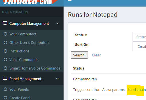

          @Steve-Lee, you mentioned a "device" so you might be talking about the TRIGGERcmd Smart Home skill. That skill creates a smart home device for each command that has the voice field filled in. The TRIGGERcmd Smart Home skill will only send on or off as a parameter.
          If you're asking about the voice parameter for the conversational Alexa skills - yes, you can pass multiple words. If you want to see what word(s) Alexa is hearing and sending to the TRIGGERcmd servers as your parameter(s), you can look at your runs list.
          The words can be anything in Alexa's vocabulary.
