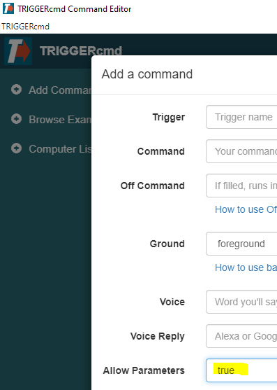

      My first doubt is if I need to sign the triggercmd to use the parameter
      according to me Brazilian and how do I give the command to alexa enter that I'm passing the parameter?
        Russ @Ruan Santana
        @Ruan-Santana, to use a parameter, you just need to set Allow Parameters to true.
        To send russ as your parameter via Alexa in portuguese, you would say something like this:
        Alexa, perguntar pra TC para executar notepad mit parameter russ”
        That would use the TC Alexa skill.
        If there's a better Alexa sentence format for Portuguese language, please tell me.
