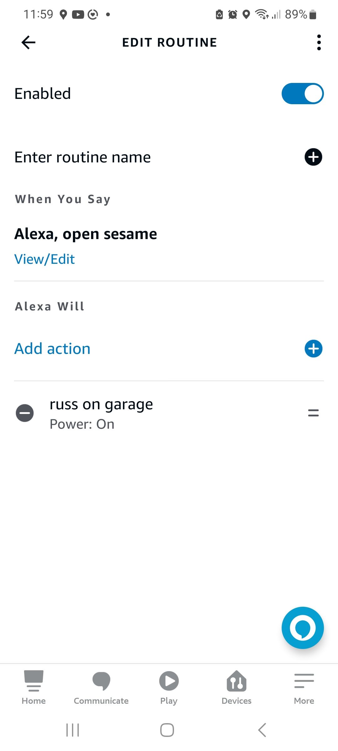

        @Mauro, I suggest you create a routine for each of your phrases. Routines let you you can say anything you want, for example, I say "Alexa, open sesame" to run routine that runs the command on my Raspberry Pi that opens my garage door. Both Google Assistant and Alexa allow you to create routines.
        This is my Alexa routine to open my garage door via the TRIGGERcmd Smart Home skill:
