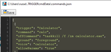

        I think your commands.json file is corrupt, so the GUI Command Editor can't read it. Maybe there's a bad character in it or something. Would you mind pasting its contents here? I'd like to see if I can see the problem. You can use the Text Command Editor to edit it.
        You could probably fix it by replacing the contents with the following text, but you'll only have 1 command called Calculator.
          "trigger": "Calculator",
          "command": "calc",
          "offCommand": "taskkill /f /im calculator.exe",
          "ground": "foreground",
          "voice": "calculator",
          "allowParams": "true"
        Alternatively, you could delete your commands.json file, then close and open the TRIGGERcmd agent. That will restore the original commands.json file.
