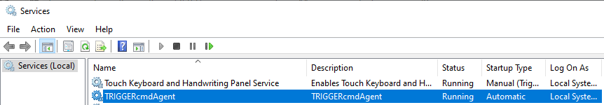

                    @Russ is there no way to install it system wide or have it so existing triggers work no matter the user?
                    I have a PC in kiosk mode and want to still be able to trigger commands for sleep, wake and reboot. If it helps, I have Anydesk installed on my user account which still runs in the background while in kiosk mode.
                      Russ @Smart Communities
                      @Smart-Communities, you could install the background service and make your commands background commands. Then they'll run in the context of the TRIGGERcmdAgent Windows service.
