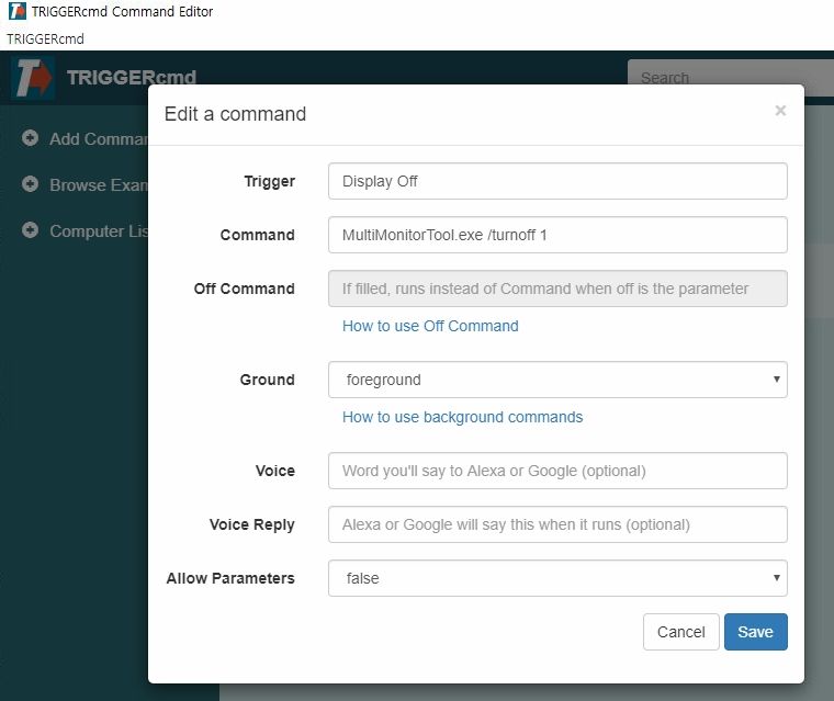

                    h6477801471 @Russ
                    Hello, Russ.
                    I have been setup my business and now I am trying to control each monitors.
                    Each bay has each monitor with a projector.
                    I input a command as you wrote it down for me.
                    However the commnd doesn't work.
                    Would you please look it what was wrong and correct for me?
                    Thank you.
