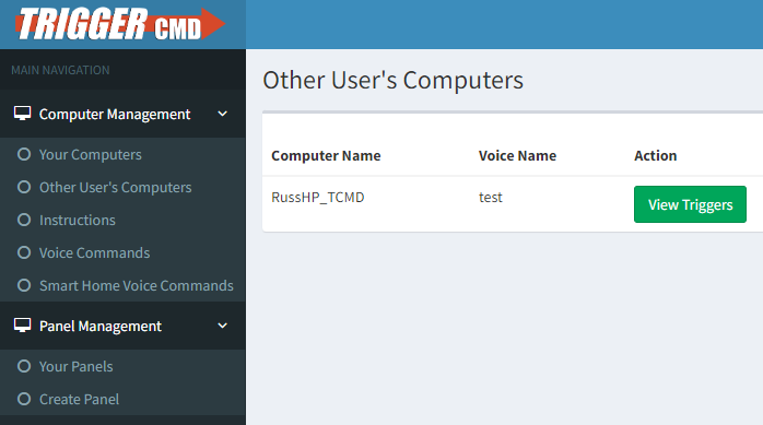

              @schmuttis, thanks that helps. Are you able to run the commands from the web interface at triggercmd.com? I figure I should confirm that before working on the voice integration. From his account you can access your computer's triggers under "Other User's Computers".
              Also, can you tell me if you see Command ran under the View Runs button for the command?
              This will tell us if the command is actually running or not. Maybe it's running and not doing anything.
