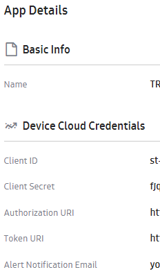

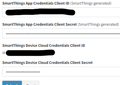

        @David-Hess, you would get that error if there's a mismatch between the Client ID value in the SmartThings Developer Workspace and the SmartThings Device Cloud Credentials Client ID field in your TRIGGERcmd user profile. The value should start with st- like you see below.
        The Client Secret value and SmartThings Device Cloud Credentials Client Secret value also need to match.
        I hope that's all it is. Please let me know.
