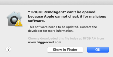

      @Alexsis-W-Regis, are you getting this error?
      If so, please right-click or CTRL-click the TRIGGERcmd Agent icon in your Applications folder, and click Open. Then click Open on this window:
      For now that's necessary to bypass Gatekeeper.
      If you're seeing something else, please send me a screenshot or a video.

        @Russ I disabled the option install unknown apps and the last time I used the agent it worked well but now is impossible and also I saw the pic you sent me
        • Alexsis W. RegisA Offline
          Alexsis W. Regis @Russ
          @Russ gatekeeper I dont have it in Catalina
