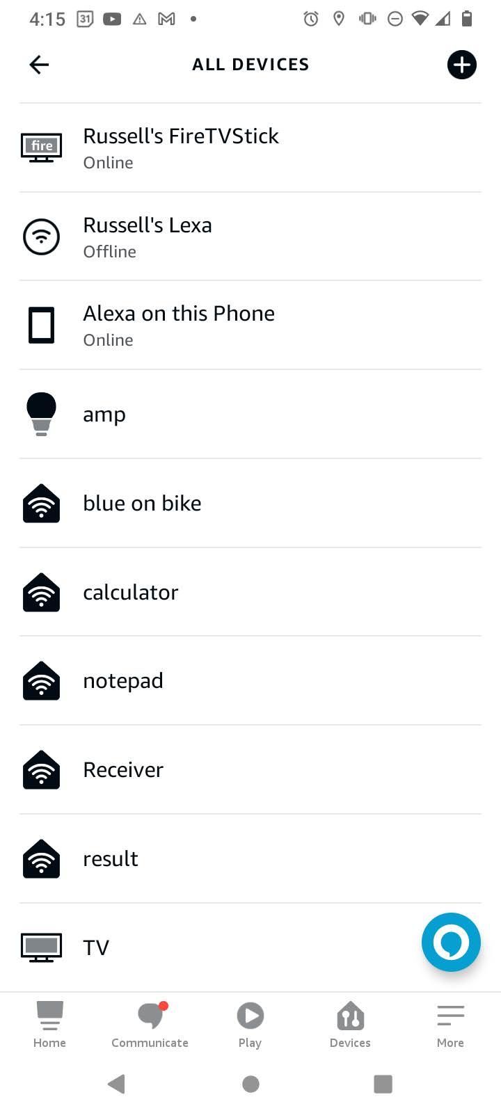

        Russ @prik m
        @prik-m, what you're seeing might be correct.
        When I go into the Alexa app on my Android phone and select the Devices tab at the bottom, then "All Device" on the right, I see the TRIGGERcmd smart home virtual devices for each of my commands, like "calculator" and "notepad":
        Then when I tap on one I see this:
