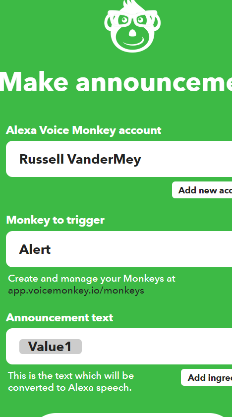

          I had another case where I couldn't use TRIGGERcmd because the purpose was to have my Echo next to my bed tell me if the TRIGGERcmd site is down. I used https://voicemonkey.io with IFTTT for that. It worked great. I have montastic.com call this endpoint which tells Alexa to have my Echo Dot speak "Trigger CMD is down"
          https://maker.ifttt.com/trigger/Montastic/with/key/(my IFTTT key)?value1=Trigger%20CMD%20is%20down
          My IFTTT applet looks like this:
