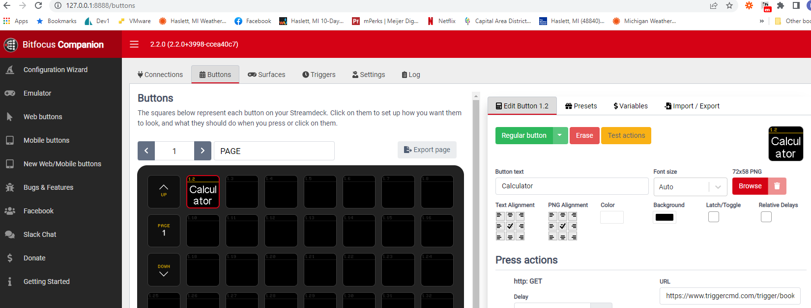

        Create a "Regular button" with http: GET as the "Press action"
        Paste the bookmark URL into the URL field (lower-right in this screenshot).
