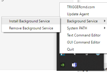

        To install background agent, you right-click the TRIGGERcmd agent icon in your tray, then click Background Service, then Install Background Service.
