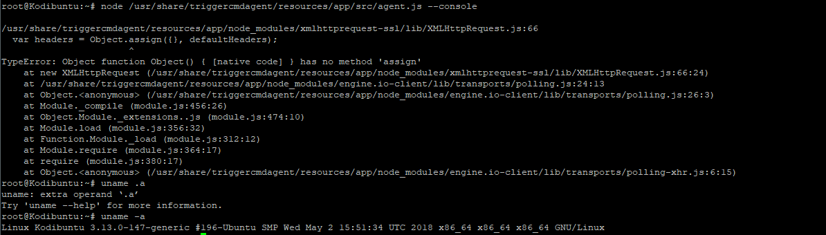

    I'm getting the following error
    I assume that it is related to the version I am using from node, could you tell me the versions with which your script works?
    I am using a Kodibunto distribution that is basically an Ubuntu 14.04.1 LTS

      @drmodding, I'll have to get back to you after I try Kodibuntu myself. So far I like your theory that the node version is too old. I don't know exactly which versions of node work, but I do know old versions don't work.
      EDIT: I installed Kodibuntu and ran into this because I'm using VirtualBox. So I'll try Ubuntu 14.04 next.
      alt text
      EDIT 2: This method worked for me on Ubuntu 14.
      sudo su -
      wget https://s3.amazonaws.com/triggercmdagents/triggercmdagent_1.0.1_amd64.deb
      dpkg -i ./triggercmdagent_1.0.1_amd64.deb
      apt-get install -f
      exit
      triggercmdagent
