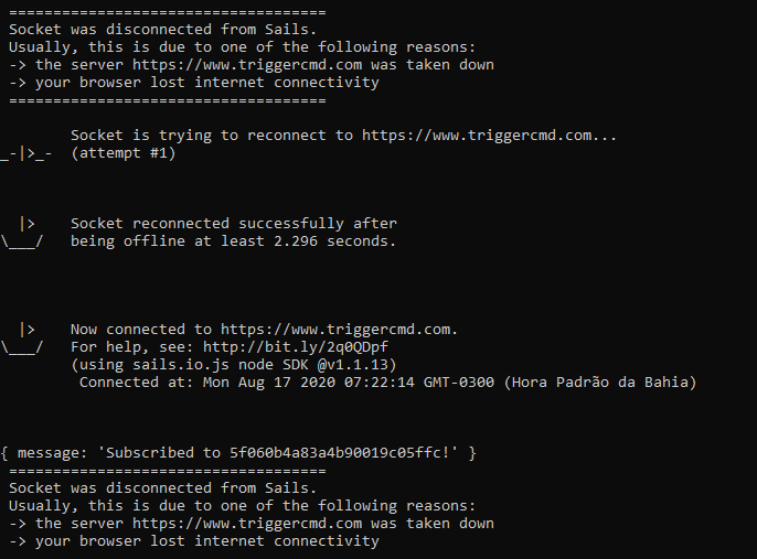

                              I'm having some problems with Skill ... A few days ago the command stopped reaching the computer. The "smart home devices" that I put on still appear on the Alexa app. I did not tamper with any settings on my computer. The command is simply not enough.
                              So I deleted it and registered my pc again on the site but it didn't work. I can only solve this when I uninstall the Trigger skill and install it again. There it works for a while until it appears in the file "triggercmdagent.bat":
                              Then it even says that the connection came back (since it did not fall) but the commands do not work at all.
                              This message keeps repeating itself.
                              I've tried several things here but I can't solve it.
                              Can you tell if this is a bug in the skill? Or is there a way to solve this permanently?
                                Russ @Emanuel
                                @Emanuel-Ferreira, if you don't use the skill and just use the Trigger buttons on triggercmd.com website does it run the commands?
                                You should confirm that works before working on the Alexa skill. We need to determine if the problem is between Alexa and the server or between the server and your agent.
                                Your screenshot only shows a 2.296 second disconnect between the agent and the server, so it seems that might not be related.
                                If you see that the commands run fine from the website, then please try changing your voice word on one of your commands. That should delete and re-create the Smart Home device in the Alexa app.
                                EmanuelE 1 Reply Last reply Reply Quote 1

                                  Emanuel @Russ
                                  @Russ The commands were working on the site, I did what you said and it worked.
