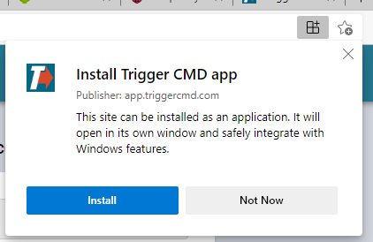

      Just go to https://app.triggercmd.com to access it. Then you can save it to your iOS, Android, or PC and it will behave like an installed app.
      This is what the app looks like on Windows, installed via Chrome:
      If you use Edge, the option to install looks like this:

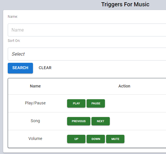

              @tuicemen , the PWA has two modes:
              • Display Computers
              • Panels
              You toggle between them using this slider:
              They roughly map to the "Your Computers" and "Your Panels" pages on the triggercmd.com site.
              Computers mode currently only gives a TRIGGER button for each command.

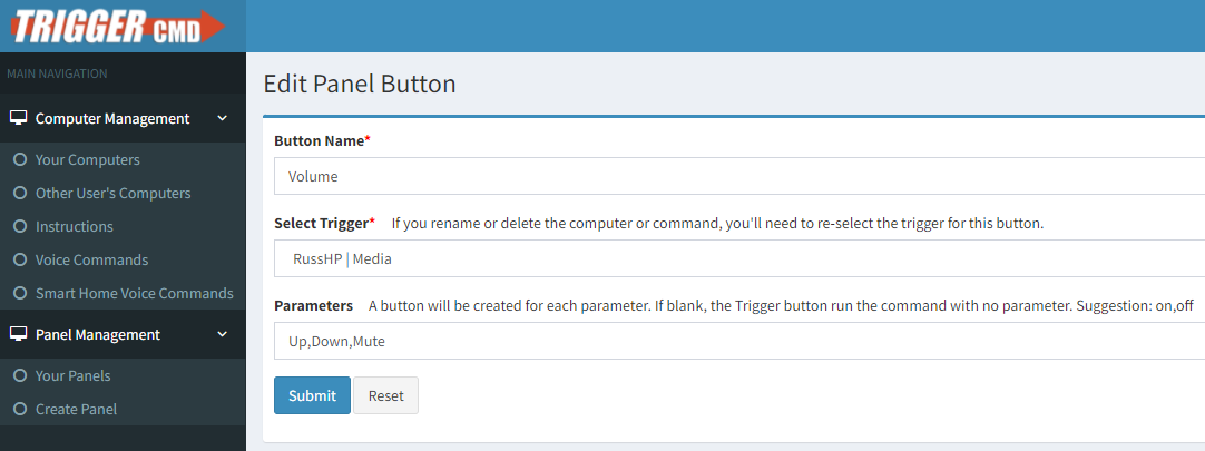

              Panels mode allows you to configure a set of buttons for each command that will send various parameter values.
              This shows the configuration for the Volume command - notice the Parameters field has Up,Down,Mute so my Music panel has those 3 buttons for the Volume command.
