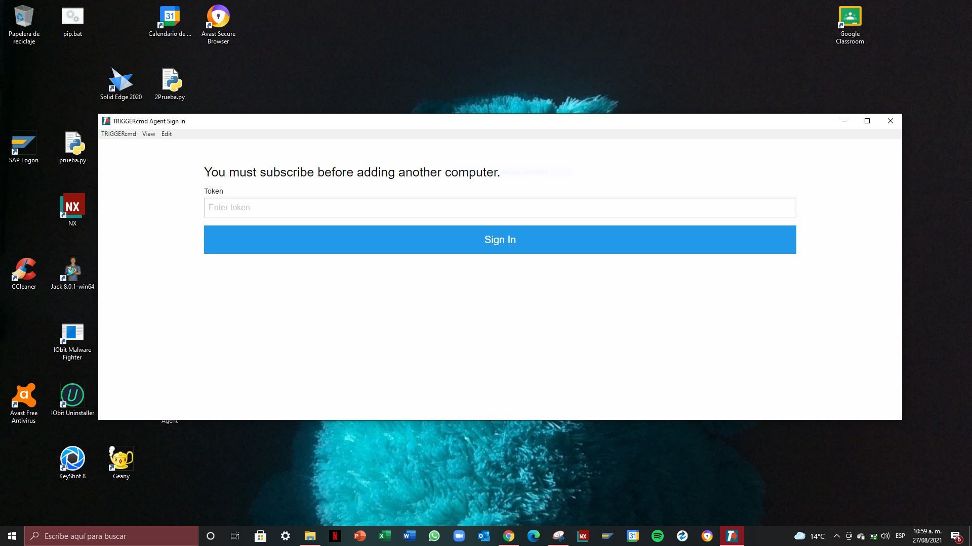

      I changed my Laptop HDD for a SSD and i did not copy the CMD carpet (i deleted everything from the HDD). Today i installed the Agent in the new SSD but when i enter my Token it says that this is not the same computer. Is there a solution or should i create another acc?
      I'm in Windows.
      • RussR Online
        Russ @Alejandro Lopez
        @Alejandro-Lopez, you can use the same TRIGGERcmd account, but if you don't have the commands.json file from your c:\Users\(username)\.TRIGGERcmdData folder, you'll need to recreate your commands because that's where they were stored. For security reasons, they're not stored in the cloud.
        You'll need to delete your old computer from your account because unless you're subscribed you can only have 1 computer.
