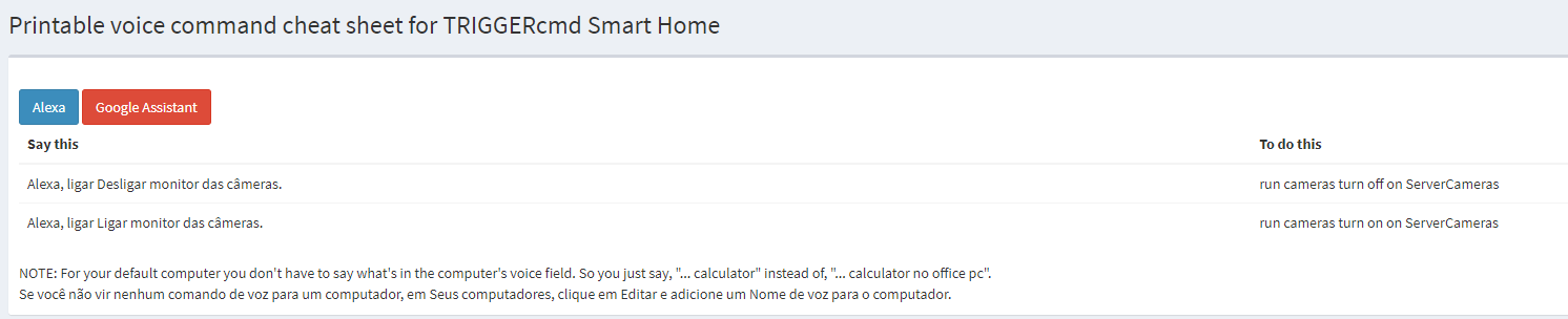

      I'm having to repeat the turn on, both to turn it on and to turn it off
      turn on = ligar

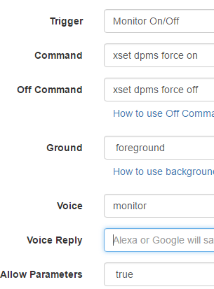

        @slugui, you should be able to combine the on and off commands into one like this:
        Then you can say these to turn the monitor on or off:
        • Alexa, ligar monitor
        • Alexa, desligar monitor
        Note: Those are the Mac on/off commands. Replace those with the Windows commands if you use Windows.

          OMG!!
          tanks, tanks, tanks...
