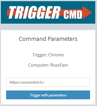

        You can test the TRIGGERcmd side like this first:
        It should open a Chrome tab with that url when the command runs.
