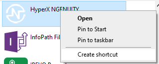

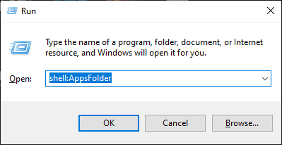

        @danyrd, here's one way to do it. You can create a shortcut for an app with these steps then execute that shortcut with start c:\shortcuts\shortcut.lnk:
        • Hold the Windows key and press R, type in shell:AppsFolder, and click OK.
        • Right-click the app and click Create shortcut
        • Click Yes to "Do you want the shortcut to be placed on the desktop instead?"
        • Cut/paste and rename the shortcut to a path like c:\shortcuts\hyperx.lnk
        • Create a TRIGGERcmd command that runs: start c:\shortcuts\hyperx.lnk
