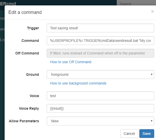

                      @Jorge-Fuentes, yes, there is a way.
                      You can use the Voice Reply field to do that.
                      This article explains how.
                      Basically, put "{{result}}" in your voicereply field and run the sendresult script that the TRIGGERcmd agent installs here:
                      Windows:
                      %USERPROFILE%\.TRIGGERcmdData\sendresult.bat
                      Linux / Mac:
                      ~/.TRIGGERcmdData/sendresult.sh

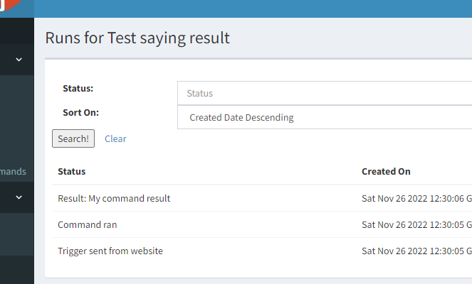

                      I know you're on a Raspberry Pi, but I'm pasting the Windows GUI editor screenshot just to make sure the concept is clear.
                      In the runs list you can see what the "sendresult" script is sending back to the server as the "result" of the command you ran. If you include {{result]] in the Voice Reply field, The TC, TRIGGERcmd, or Trigger Command Alexa skills will say that text when you use one of those skills to trigger the command.
                      Instead of making the command in the commands.json file directly run the sendresult script, normally the commands.json would reference a script that would run the sendresult script last, and send back the value of an environment variable like this:
                      ~/.TRIGGERcmdData/sendresult.sh ${RESULT}
                      The one problem with the above method is it uses one of the non-smart home TRIGGERcmd Alexa skills. Those skills are not as reliable at matching the words in the sentence pattern it uses to run the command. The TRIGGERcmd Smart Home Alexa skill does a much better job.
