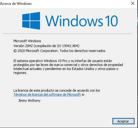

      Always the trigggercmdagent service is off when i turn on after 10 seconds the service is off, only i can use it with foreground mode not with bacground mode. Please help! winver.PNG

        @JIMMY-GUTIERREZ-NINAHUAMAN, I see you have version 20H2 of Windows 10, and Microsoft is not making it available to everyone yet. I tried to update a couple of my Windows 10 PC's to get the new version and it wasn't available to me.
