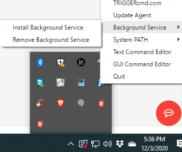

        On Windows you can install the background agent (aka service) like this:
        Use one of these commands to install the background agent (aka daemon) on Linux:
        sudo sh /usr/share/triggercmdagent/resources/app/src/installdaemon.sh
        sudo sh /usr/lib/triggercmdagent/resources/app/src/installdaemon.sh (newer Ubuntu OS's)
