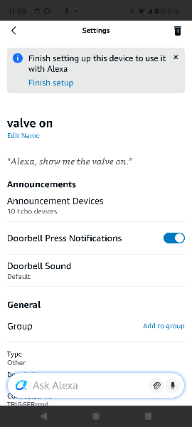

          @Vinicius-Gimenez-Figuerola, I noticed the same thing yesterday. When I trigger a new or changed command via the virtual Alexa Smart Home device, my Echo device says, "Ding dong, someone is at [voice word]." Old commands are not affected.
          For now, I set my Alexa device to "Do Not Disturb" so I don't hear the announcement like this article suggested:
          https://www.amazon.com/gp/help/customer/display.html?nodeId=GV7ZJNSWKL8E3D7T
          I'm looking into what changed. I think Amazon changed something recently because I didn't change anything related to the doorbell feature. You probably know this, but the doorbell feature is needed to trigger an Alexa routine when a command runs.
          It doesn't have anything to do with the Voice/MCP Reply field. The TRIGGERcmd Smart Home Alexa skill doesn't use it. Only the legacy conversational Alexa skills (called TRIGGERcmd, Trigger Command, and TC) use it.

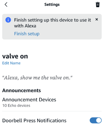

              EDIT: I tried it - that works, but I don't want everyone to have to do that for every command, so I'm still looking for a solution. Worst case, I could make the doorbell feature (for running routines) a toggle for each command, and default it to false.
              EDIT2: I added a feature to each device to allow you to disable the "Doorbell Press Notifications".

                  @Vinicius-Gimenez-Figuerola if you rename your command, and rename it back, it will re-create the Alexa device with this new UI option to disable the doorbell press notifications. Does that solve it? I tried to default it to false, but there doesn't seem to be a way to do that.

                    @Russ oohh the option to disable the doorbell press notification for me just appeared without I've done nothing and yes it works if I disable this Alexa won't notify anymore, very good 😁
