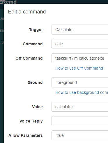

      There's a new field called "Off Command" that will allow you to specify a command to run when the parameter is off, which is the case when you set Allow Parameters to true and use one of the TRIGGERcmd Smart Home Alexa skill or Google Assistant action.
      If parameters are enabled and this field is filled, Command will run when the parameter is on and Off Command will run when the parameter is off.
      The commands will run without " on" or " off" appended to the end. If you want those appended to your command, then leave the Off Command field blank, and use the Command field to run a script that expects on or off as the parameter.
      So with this example, you can say, "Alexa, turn off calculator" and calculator will close.
      alt text

                    Russ @Rob Lee
                    @Rob-Lee, the "Off Command" field is greyed out if "Allow Parameters" is set to false.
                    Allow Parameters has to be true if you want to use the Off Command field.
                    I'm glad you asked, because it's not particularly intuitive.

                        Russ @DJ
                        @DJ, if you want to do something else when you tell Alexa/Google to turn the virtual device off, you need to populate the Off Command field set Allow Parameters to true.
                        In this screenshot you'll see I'm closing calculator when Alexa turns the device off.
