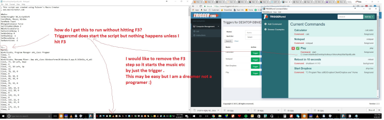

<?xml version="1.0" encoding="UTF-8"?><rss xmlns:dc="http://purl.org/dc/elements/1.1/" xmlns:content="http://purl.org/rss/1.0/modules/content/" xmlns:atom="http://www.w3.org/2005/Atom" version="2.0"><channel><title><![CDATA[Please Help with scripts (I am a non programmer)]]></title><description><![CDATA[<p dir="auto">Hotkey, scripts![alt text](<img src="/forum/assets/uploads/files/1505970088889-help-please-resized.jpeg" alt="0_1505970100290_help please.jpg" class=" img-fluid img-markdown" /> image url)</p>
]]></description><link>https://www.triggercmd.com/forum/topic/82/please-help-with-scripts-i-am-a-non-programmer</link><generator>RSS for Node</generator><lastBuildDate>Fri, 10 Jul 2026 17:38:28 GMT</lastBuildDate><atom:link href="https://www.triggercmd.com/forum/topic/82.rss" rel="self" type="application/rss+xml"/><pubDate>Thu, 21 Sep 2017 04:59:38 GMT</pubDate><ttl>60</ttl><item><title><![CDATA[Reply to Please Help with scripts (I am a non programmer) on Sun, 24 Sep 2017 01:10:28 GMT]]></title><description><![CDATA[<p dir="auto"><a class="mention plugin-mentions-user plugin-mentions-a" href="https://www.triggercmd.com/forum/uid/1">@Russ</a> thanks</p>
]]></description><link>https://www.triggercmd.com/forum/post/234</link><guid isPermaLink="true">https://www.triggercmd.com/forum/post/234</guid><dc:creator><![CDATA[Nate Hales]]></dc:creator><pubDate>Sun, 24 Sep 2017 01:10:28 GMT</pubDate></item><item><title><![CDATA[Reply to Please Help with scripts (I am a non programmer) on Thu, 21 Sep 2017 23:06:35 GMT]]></title><description><![CDATA[<p dir="auto"><a class="mention plugin-mentions-user plugin-mentions-a" href="https://www.triggercmd.com/forum/uid/33">@Nate-Hales</a>,</p>
<p dir="auto">I think you just have to remove that <strong>F3::</strong> line.</p>
<p dir="auto">I tested using this script.</p>
<pre><code>F3::
Macro1:
Send {Volume_Mute}
</code></pre>
<p dir="auto">When I ran it it did nothing until I pressed the F3 key.  Then I removed that line, and it toggled mute on or off when I ran the script.</p>
