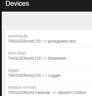

            If you go to https://alexa.amazon.com, under Smart Home, Devices, do you see the device for the command you want to run?
            They look like this:
            Even if you do see it, you should try clicking Remove All, then Discover to re-discover your commands.

              @Russ Accessing the page, I see all the devices, exactly as they should.
