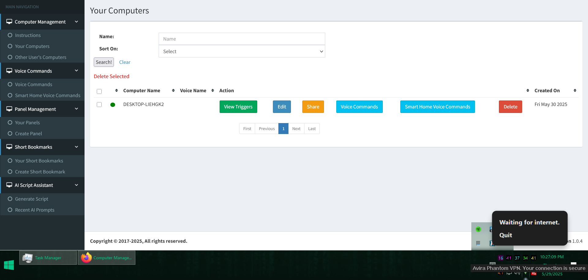

          @Russ Reinstalled new version and the services start properly and shows on account my computer is connected with green dot BUT it still shows waiting for internet in tray and triggers are not working,

            @Russ it looks like its not at startup the problem only occurs for me cause. When i close all services with no internet and start triggercmd again and shows tray with "waiting for internet" and then I connect to internet(with and without VPN), it still had issue. It just needs internet for me for it to start up properly. I tried setting the main exe and the demon exe as admin and no luck.
            In short if no internet at startup, triggercmd does not start properly. I don't know if something else can cause a conflict at startup&no-internet with triggercmd. Really weird.
            Startup with no internet - issue
            After startup issue, connect to internet - still issue
            Startup with internet - works
            After startup issue, I force close and restart with internet - works
