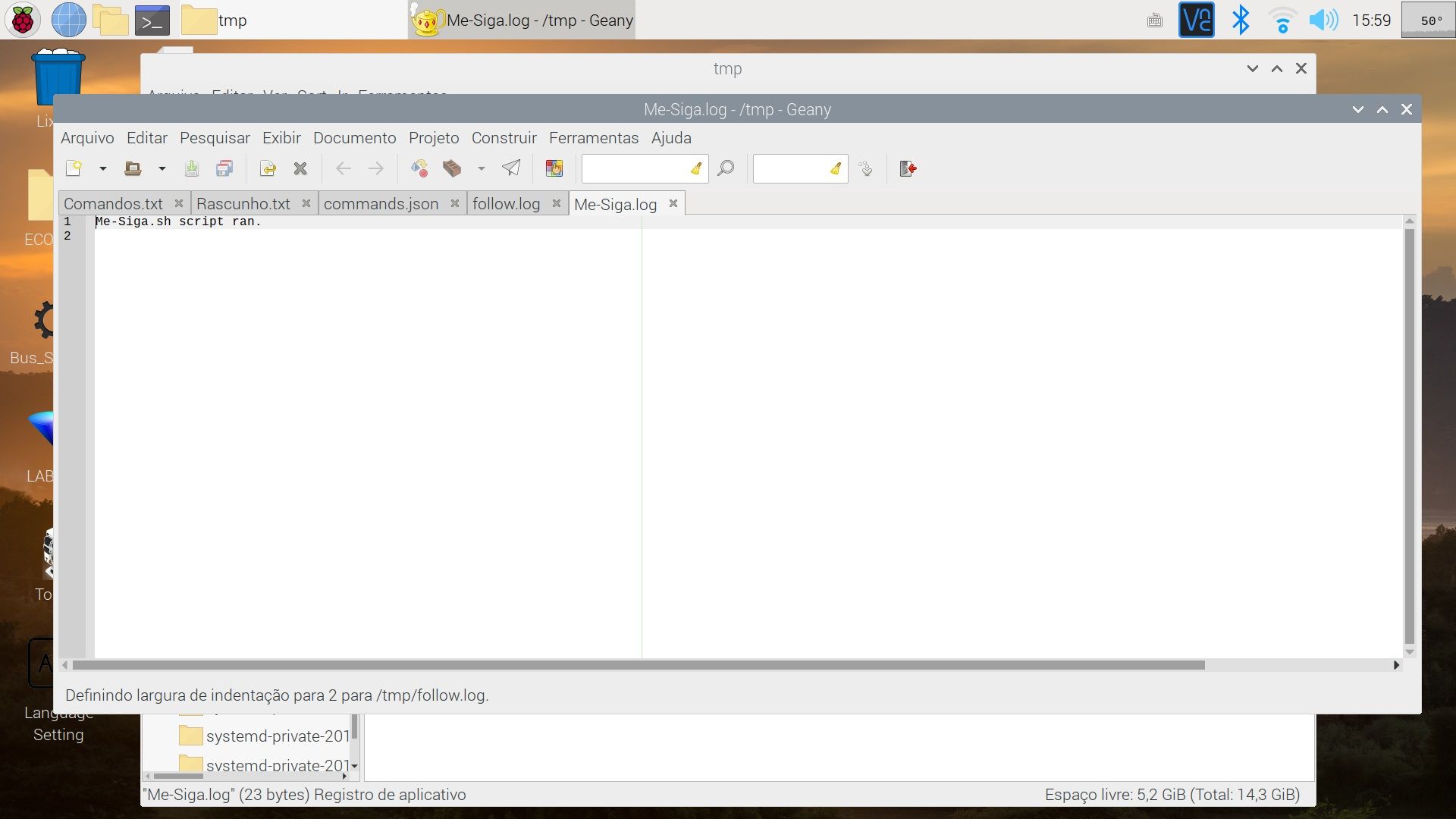

        @Russ said in Tentando Executar um Script python no terminal LX com o TriggerCMD mas não estou conseguindo:
        cat /tmp/Me-Siga.log
        Também quando executo esse comando: cat /tmp/Me-Siga.log recebo isso: Me-Siga.sh script ran.
          Russ @Antonio Francisco S.Santos
          @Antonio-Francisco-S-Santos, good, so this line that you added to your script
          echo "Me-Siga.sh script ran." >> /tmp/Me-Siga.log
          Must have writen this to your /tmp/Me-Siga.log file:
          Did it add that line when your ran the script manually as root? Or when you ran it via TRIGGERcmd? If you don't know, can you test that? Just cat the log before and after you run it.
          I just want to establish whether TRIGGERcmd is running your script or not before troubleshooting the content of your script.
