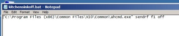

          and in that file I have
          "C:\Program Files (x86)\Common Files\X10\Common\ahcmd.exe" sendrf f16 on
          It did not work. So then I clicked on the 'PLAY" icon in the GUI. It also did not work.

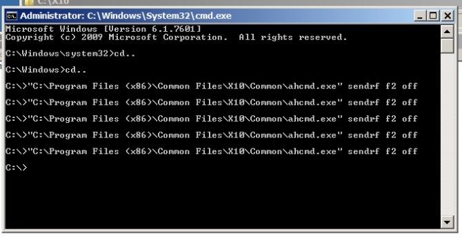

              As for executing from the command line, it has failed just about as often. In fact, after about 6 google voice commands turning on/off various lights that did work, trying to turn off one light failed via google. I then went to ADMIN CMD prompt and entered the command. It failed. I tried 4 times. All 4 failed. Then, as I typed this and tried to capture the screen to paste here, I accidently executed it again. This time it worked... 😞 ![alt text]ScreenShot001.jpg
              Now, that light is working fine via google voice commands - just tried it 4 times. Have a good one...
              UPDATE: And now it is not - voice or CMD prompt. But working 100% from AHP screen. What the heck is going on...

                @Frank-Malczewski Hmmm. Question. The bat files I created say to sendrf f2 off.
                Does this mean the computer is not using the AHP/CM15A interface but rather sending a rf signal and maybe that is what is failing (if the remote receiver is too far away) but when I do it from within the AHP program, it is going via USB to the CM15A and into the wires directly? I only have one of the remote receivers located upstairs (found with two there was too much interference). But there is also an antenna on the CM15A. Not sure how this is working (actually, not working)...
                • RussR Online
                  Russ @Frank Malczewski
                  @Frank-Malczewski, I like the theory RF would likely be less reliable than sending the signal through your house wires.

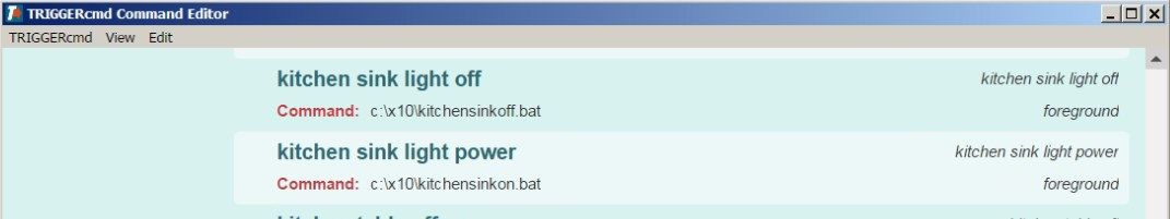

                    @Russ I watched the video about using Google smart home and got partly started but hit a snag not knowing what to do. I did get the service linked and now I see all my light switches in the Linked To You part of HOME, not assigned to any room. But that is where I failed to get further as I don't understand the bat files I now need to create, what folder to put them in, what to call them, and the purpose of a voice name. If I could beg for some assistance, here is what I have. On the computer called server where TC resides, I have a folder C:X10 where I stored some 34 files dealing with turning the light switches on and off. Here is just one to show the context:
                    In TC GUI I have:
                    Which is programmed as follows:
                    I assume all these similar on/off bat files are no longer good. When I went to TC and checked into voice commands, I see a long list:
                    but they don't do anything, although if I say Hey Google, turn off the kitchen sink light it says it is doing it but of course nothing happens.
                    I assume the disconnect is the .bat files. Could you give the proper syntax for just one light, and the programming needed for the GUI? I assume I can leave the new bat files in the same folder. And do I need a voice name for my 'server'?ScreenShot002.jpg
                    Thanks.

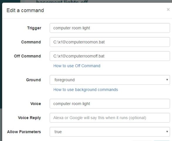

                      @Frank-Malczewski, you have 2 options.
                      Option 1: Use your current .bat files, turn on parameters, and setup your commands like this:
                      Command: c:\x10\kitchensinkon.bat
                      Off Command: c:\x10\kitchensinkoff.bat
                      Allow Parameters: true
                      Option 2: Use one batch file for each light, and don't fill in the Off Command so the Command runs with " on" or " off" parameters.
                      The batch file would insert the on or off parameter where %1 is in the .bat file. So your batch file would look like this:
                      c:\Program Files (x86)\Common Files\x10\Common\ahcmd.exe" sendrf f1 %1
                      Command: c:\x10\kitchensink.bat

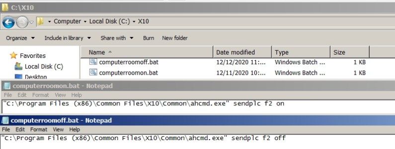

                      About sending the signal to your X10 devices through your 15 amp power line (plc) instead of over the air (rf),
                      c:\Program Files (x86)\Common Files\x10\Common\ahcmd.exe" sendplc f1 on
                      It's sendplc and sendrf because:
                      plc = power line command
                      rf = radio freqency
                      Frank MalczewskiF 1 Reply Last reply Reply Quote 0

                            @Russ So I went with option 1. Thought it was easier and I don't plan to make many changes once done.
                            And YES, the SENDPLC command seems to be working much better BUT too early to tell. I changed each .bat file over to it. Time will tell.
                            Lastly, I didn't know if I needed to do something about the "VOICE NAME" column for my computer. Right now it is blank (see screenshot above). What is its purpose?

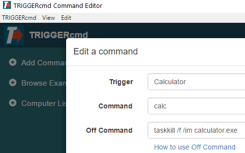

                              @Frank-Malczewski, good question - the voice name field for the computer is really only needed for your non-default computer(s). Notice you don't have a "Voice Commands" or "Smart Home Voice Commands" button for serverDell. That's because it's not your default computer and you don't have a voice name for it.
                              You can run commands on your default computer by saying the command without the " on (voice name of your computer)" part.
                              If you give your serverDell computer a voice name of, "dell", you'll be able to say, "Hey Google, turn on calculator on dell."
                              If you say, "Hey Google, turn on calculator," it will run calculator on your default computer which is Server.
                              Frank MalczewskiF 1 Reply Last reply Reply Quote 1
